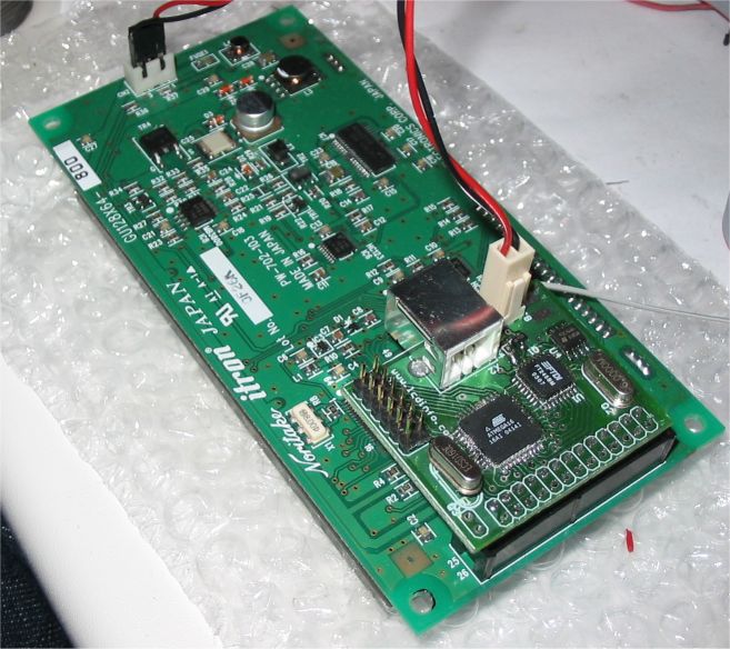

Also been working on a VFD USB board:
Noritake GU128x64-800:

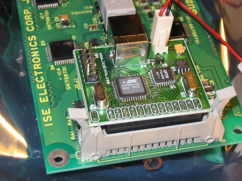

Noritake GU256x64-355:
As you can see it's not exact fit to the locking connector in the -355 as it was not designed with that display model in mind. But it works.
Board works with GU256x64-372 too and has no fitting problems as it uses same kind connector as the GU128x64-800. Works with some others from the -3xx series also but I haven't tested myself as I don't have the displays.

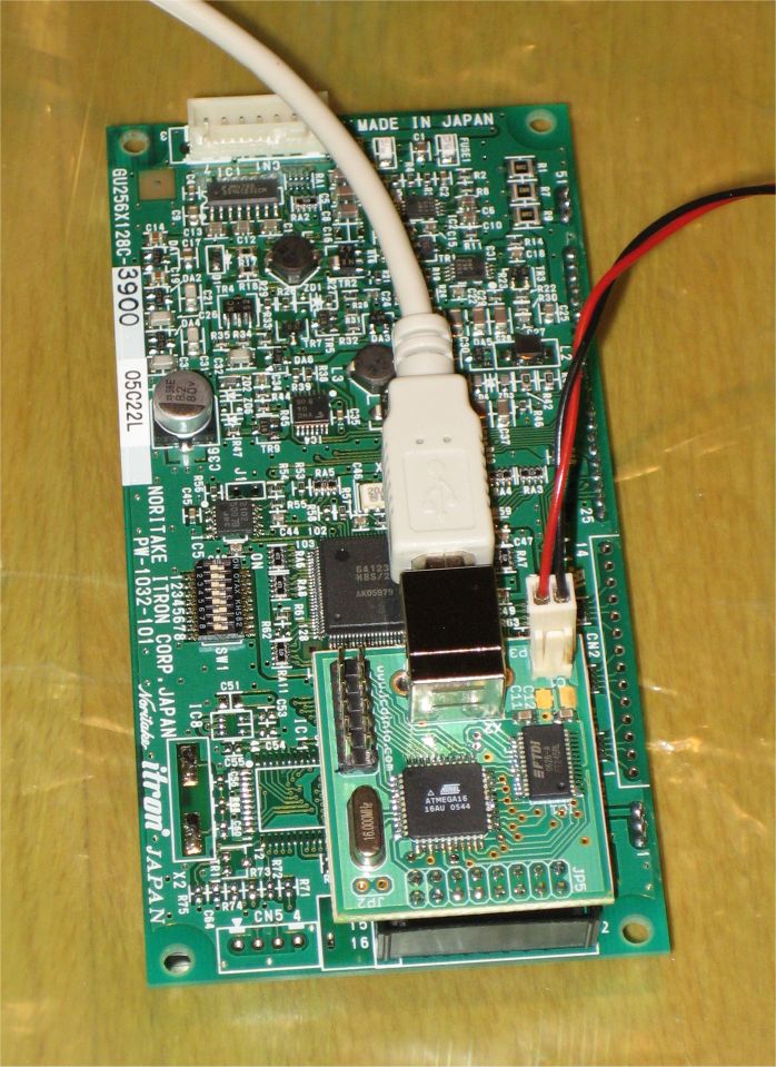

Board for the Noritake 3900 series VFD displays also available now. Currently supported sizes are 256x128 and 256x64 pixels but other sizes can be added if needed.

And do i spy GPO jumpers maybe ?

I was waiting for you Trev :lol: Yes GPO for future toys :P

Yes the expansion header in the board can be used for GPIO so something could be controlled with it or maybe buttons added. Also hardware PWM for few outputs is possible. And there are couple pins connected to the AD converter so analog input is also possibility.
