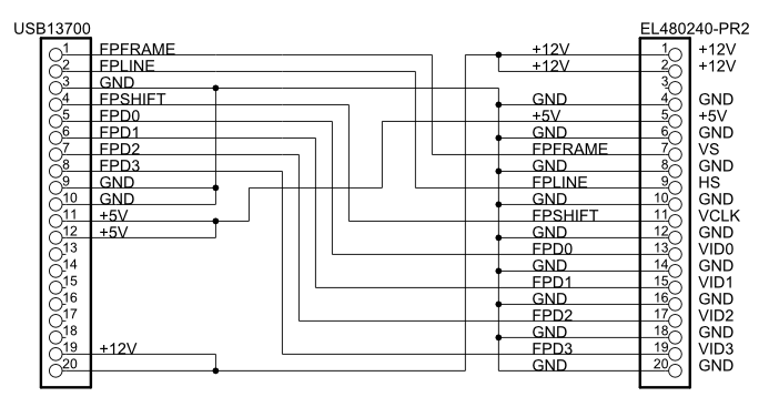

Connecting Planar EL480.240-PR2 display to the USB13700 controller.
http://www.planar.com/products/docs/IBU ... 47_00A.pdf

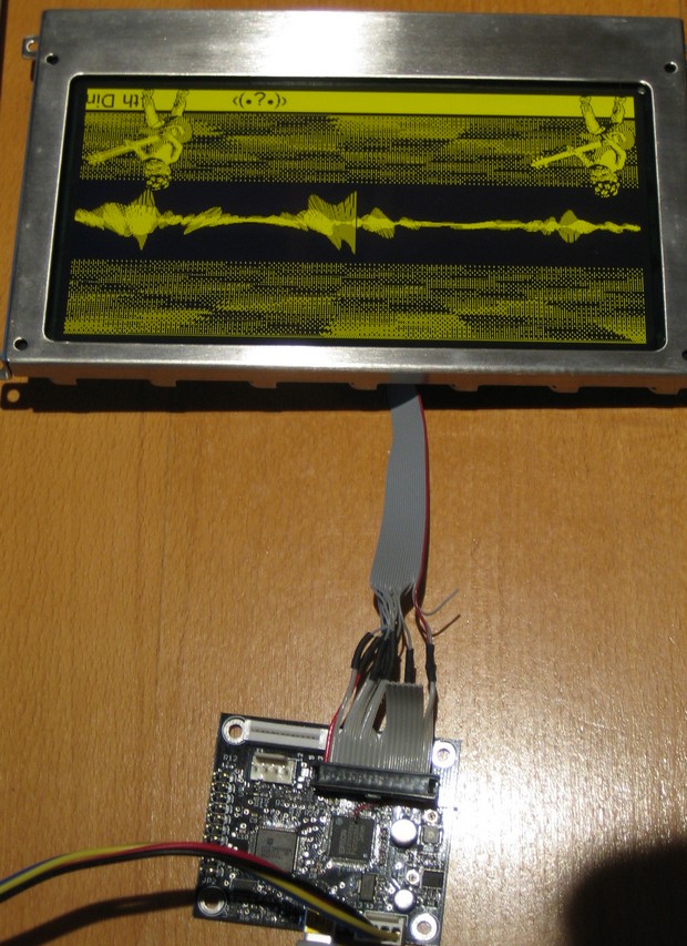

I got one and the wiring works god.
You can watch a little Video (1:38 25mb).
http://de.youtube.com/watch?v=cuyRVhG0l5c
I post some Pictures later.

Here the pictures
PostPosted: Thu Nov 06, 2008 12:57
Here's one more picture of the display
