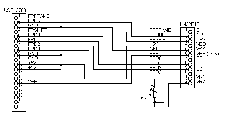

Following schematic shows the connection to Sharp LM32P10 LCD.
The same pinout is used also in the LM32K10 and LM32K102 models.
