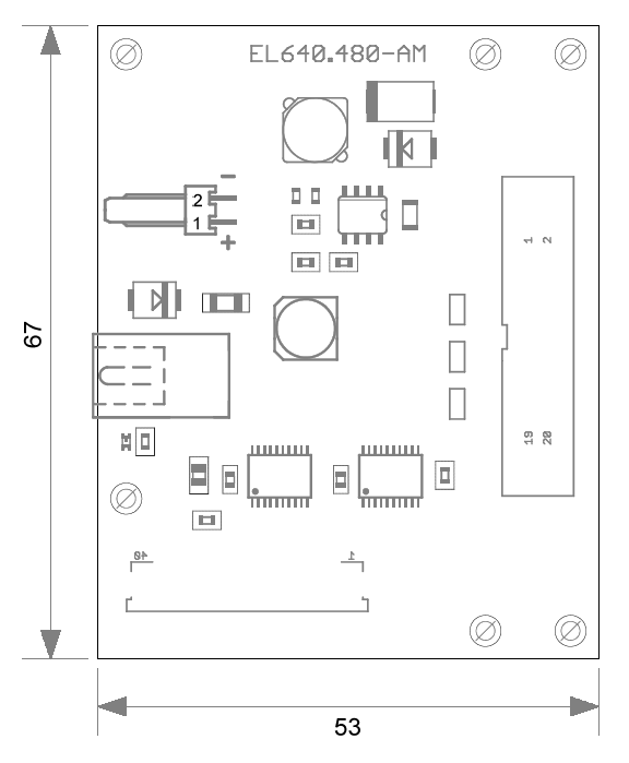

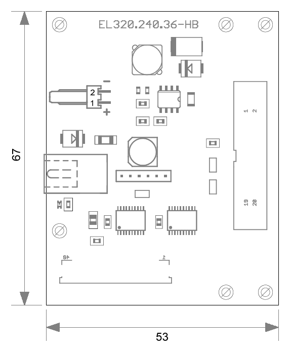

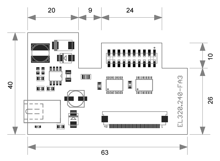

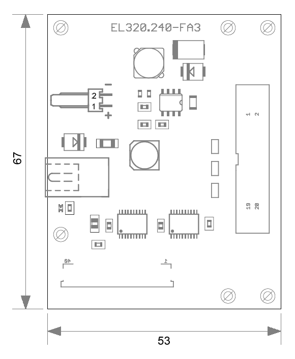

Some Planar EL displays have been tested using the USBD480 with custom FPGA configuration as a controller now.
Here are adapter boards that have been designed to be mounted on top of the existing USBD480 board:
And then slightly different one that would mount directly to the connector of the display:
