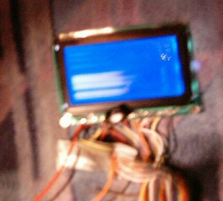

I made a pic of how the display looks after having been connected - but havent got any web space, nor do i know how to upload stuff :(
anyone who could do this for me? would send the pic attached to an e-mail to however could.
when the lines disappear they first become very dark for a short time, and they disappear from the right to the left.
So it looks like that: right side - blue, left side - some white lines, where the white lines just disappeared there are some (3-4 i guess) nearly black pixel
Just send them to the address in my profile and I'll upload it to this server.

the picture:

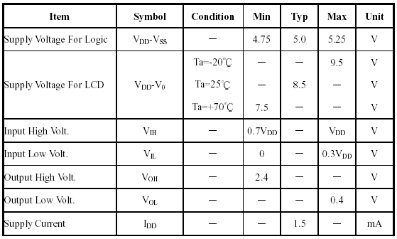

Picture below is from the datasheet. Looking at it the LCD supply voltage (Vdd-Vo) should be about 8.5V.
Symbols:
Vdd = +5V
Vss = GND
Vo = negative contrast voltage
Vo (pin3) should be about -3.5V to get the LCD supply voltage to required levels.
So it looks like there is something wrong with your display. How about the Vee (pin18) ? What's the voltage there ?
