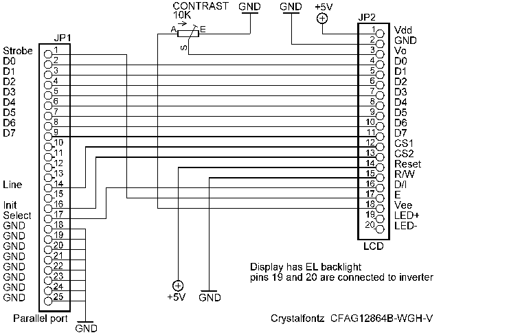

I've got a CFAG12864B-WGH-V and it is all wired up. I thought I had it wired up correctly but I guess I don't.
When I ran LCD Info, my display would flash whenever lcd info would update, but it wouldn't display any information.
My question is, do I have a wiring issue or a timing issue? Any idea what line might cause that error?

It might be either wiring or timing problem. How long is your wiring ? Have you tried with different delay values in LCDInfo ?

Ok, as the result is same with all those programs I'd think you have a wiring problem.
Are you getting enough contrast ? If you turn the contrast potentiometer to the maximum do you have dark display ? If you don't you should check this:
http://www.skippari.net/phpBB2/viewtopic.php?p=208#208
You could also try measuring what the contrast voltage is.
Also I'd recommend measuring all voltages to make sure they are ok. I don't know of any special wire that would cause the problem so I recommend checking them all carefully.

I just happened to check the Crystalfontz forum and saw that you have asked about this there also: http://www.crystalfontz.com/forum/showt ... eadid=1420
There you posted the schematic for the Displaytech 64128A display.
Are you really using that as I have made a schematic for CFAG12864B-WGH-V also ?
You also said that you are using 20 ohm resistor for the backlight. Do you have the CFAG12864B-WGH-V display as you aren't supposed to use any resistors with that as it has an EL backlight.

You're right, I posted the wrong schematic for my display, but I used the right one to wire up my lcd. Also, the model I listed was the wrong one. I have the TMI-V which has the led backlight. I've tested all the lines and the data appears to be going to the right lines, so I am lost.

Ok, so everything should be fine with the wiring.
Do you have a ground wire from the LPT connector to the LCD ?
