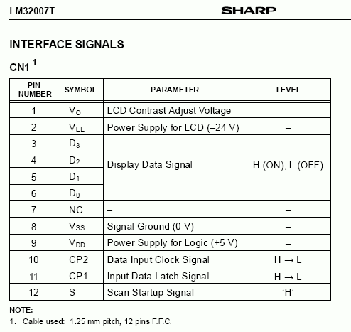

This is the pinout that the controller has
You could try measuring with a multimeter where the pins from the 12 pin connector on your board go and compare to the above pinout. First I'd check the power pins like VDD and GND and if those match then continue trying to figure out the rest. If the power pins match I think there's a pretty good chance the rest is in the same order too.

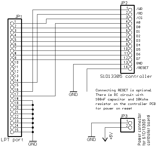

Hey i was wondering how i would go about hooking the lcd controller board to my pc, printer port? most of these screens i have read about are connected through the printer port.
PostPosted: Thu Apr 26, 2007 14:12
Even if you don't use the touchscreen you might think of it as a plus, as if you want, you could remove the touchscreen glass and under it you should find an untouched lcd glass without any scratches or other marks that can be often seen in used displays.
Yes this controller would be connected to printer port. That is the way the common software supports connecting these controllers.
Not very complicated wiring as all the "difficult" stuff is handled on the controller board.

great diagram thanks for the help, what sort of software would i be using to control it any you would suggest?

I happen to own a Sharp LM32015t, which is compatible with the pinout of the sharp lm32007 discussed in this topic.I managed to get the voltage pump working, and assembled a led backlight instead of the ccfl one.my problem is that i do not know how to match the following pins: CP1, CP2, S with the control pins from the lpt side: /WR, /RD, /CS, A0.
