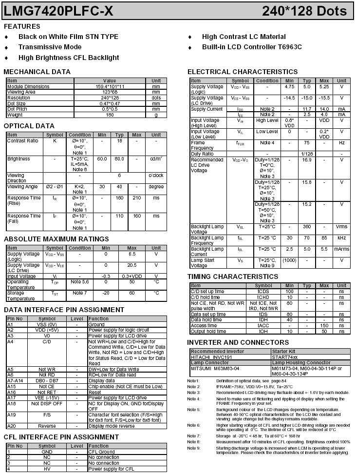

how do i have to connect this display with the parallel port ?

This is for different model and there are some differences but it might be of some help:
http://chrix.woaf.net/hitachi/
Your display has the FS pin for font size selection so you don't need to do the soldering on the T6963C chip pins.
And here are the datas for your display:
