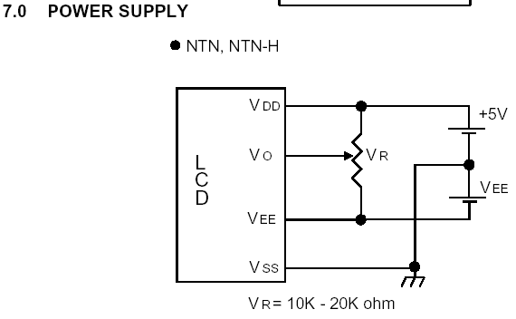

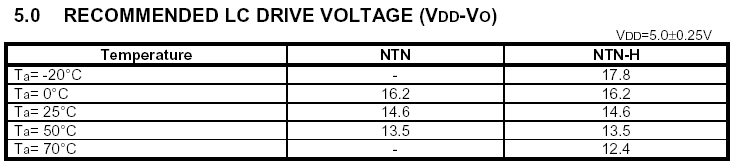

Yes, these two pictures should show how to connect the voltages and what voltage is needed:
What this is saying is that at 25C the Vdd to Vo voltage should be 14.6V. As the Vdd is +5v you need at least -9.6v for the Vee. So maybe -12 would be good value for Vee but -10v should be enough.
From here you can see how to connect the contrast potentiometer (Vr) between the voltages and lcd pins.
