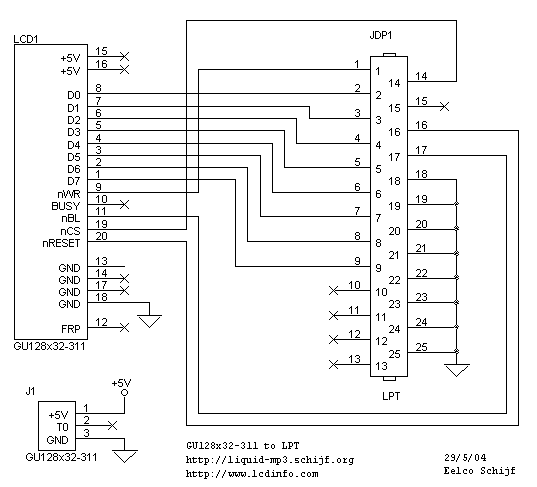

 Post subject: Noritake GU128x32-311
PostPosted: Wed Dec 29, 2004 14:33
User avatar
Joined: Sat Apr 17, 2004 17:42
Posts: 467
Location: The Netherlands
Here's the wiring scheme for the Noritake GU128x32-311. Note this is a custom model and not the 311 series you can find on the Noritake website.
edit:
Here's a connection parts list based on Futurlec stuff, only thing missing is the female Molex.
Also the 20way connector and 3pin power connector won't fit the headers without some (little) cutting.
IDCC20 - 20 Contact IDC Socket Connector
DSUBSCM25 - 25 Contact Male Solder Cup Connector
DSUBCH25 - 25 Pin Connector Hood
POLHDCON3 - 3 Pin .100" Polarized Header Connector
PLHDPIN - Crimp Pin for Header Connector
GRCABLE20 - Grey Ribbon Cable - 20 core
So do it the right way and it looks like this 8)
My Plexeon-Insane LCD!-Or this one!-LCDinfo-LCDStudio

PostPosted: Sat Jan 15, 2005 3:07
Joined: Sat Jan 15, 2005 3:02
I'm new to this and probably should've picked a standard LCD, but I need to clearify a few ?'s. What are the pin Pin 10 (busy) where does this go to on the parallel and Pin 12 (frp) same question. Also can I use a standard 34 pin floppy connector --> Parallel connector.
PostPosted: Sat Jan 15, 2005 11:42
User avatar
Posts: 467
Why afraid of the VFD, they're actually easier to wire than LCD's!
Pin 10 & 12 are not connected, so that saves you some soldering :D.
You need a 20-way header or hack up that 34-way floppy connector. Also i noticed standard IDC form connectors won't fit the shrouded header; the short sides of the plastic shroud need to be cut off (carefully).
