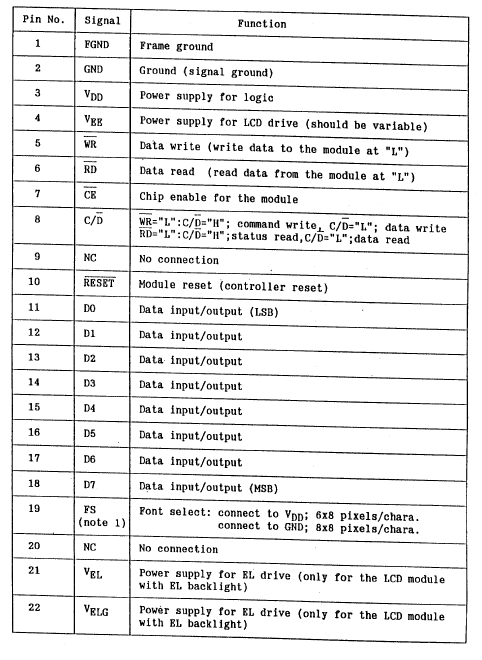

Waqar-Ul-Hasnain Khokhar wrote:
I need help in Contrast circuit and voltage of Toshiba graphic LCD
TLX-1013-EO
Thankyou
Hasnain
Pakistan
swifthouse@hotmail.com
It seems to be similar than the TLX711A display here:
http://www.skippari.net/lcd/t6963c_schem.html
