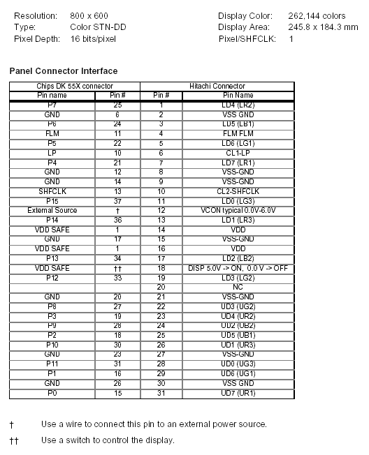

Hai, could someone help me, i have 1 psc LCD display and is it possible to connect this lcd to LPT port. or maybe to other device or connect to my desktop. i dun know the pinout configuration. i hope u guz could help me..

So the pinout for the display can be found from this document:
http://www.intel.com/design/graphics/mo ... 119001.pdf
You can see it's a 800x600 pixel STN panel. This isn't very suitable for connecting to LPT port. It can be done with right hardware but if you need to ask how to do that it's probably not good option for you. This kind lcd would be more appropriate for a VGA connected secondary display. But also there you need a controller that might not be very cheap. And if you go buy a controller then it's better get a TFT panel to use with the controller...
So there isn't any simple way to connect it to parallel port.
