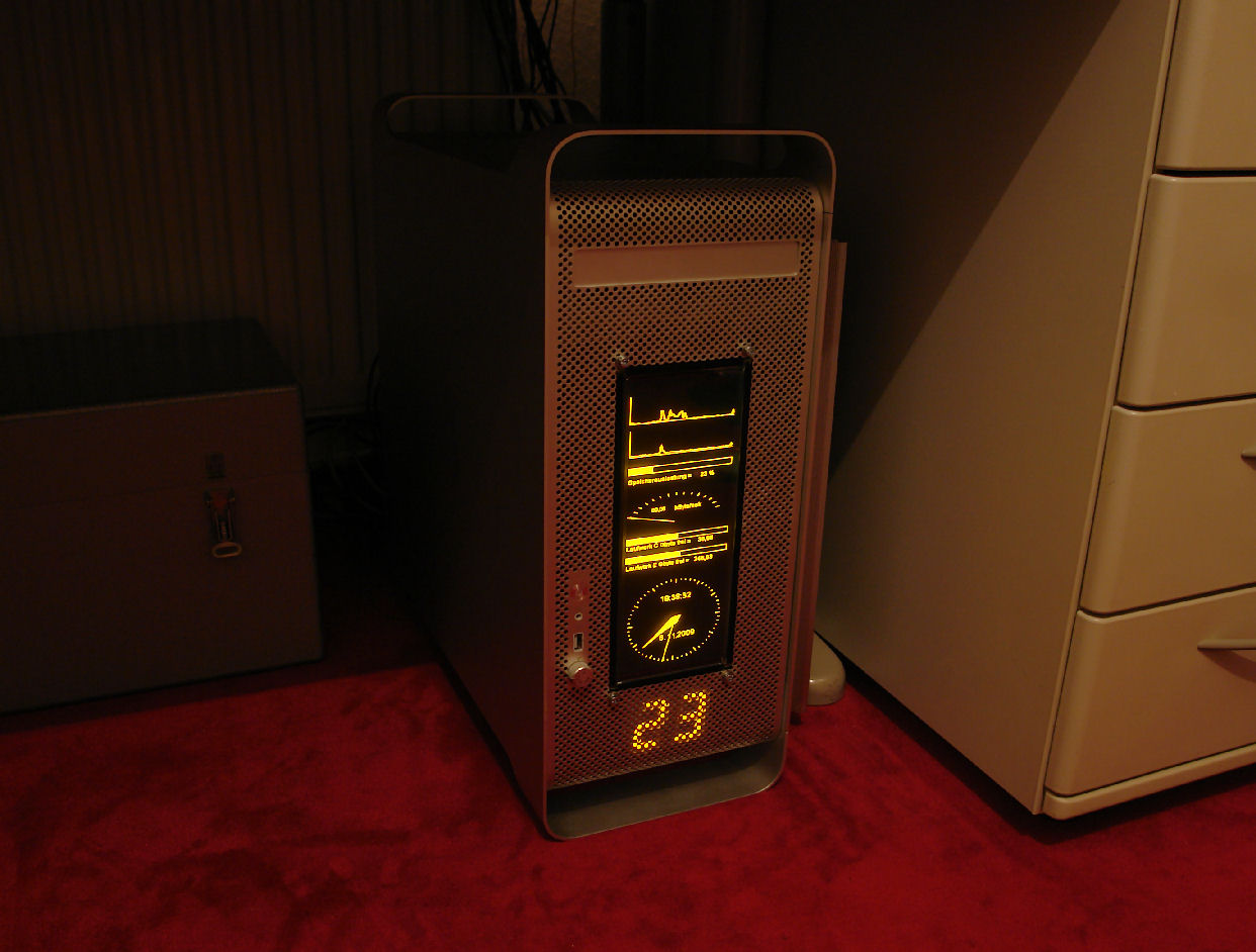

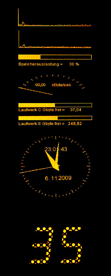

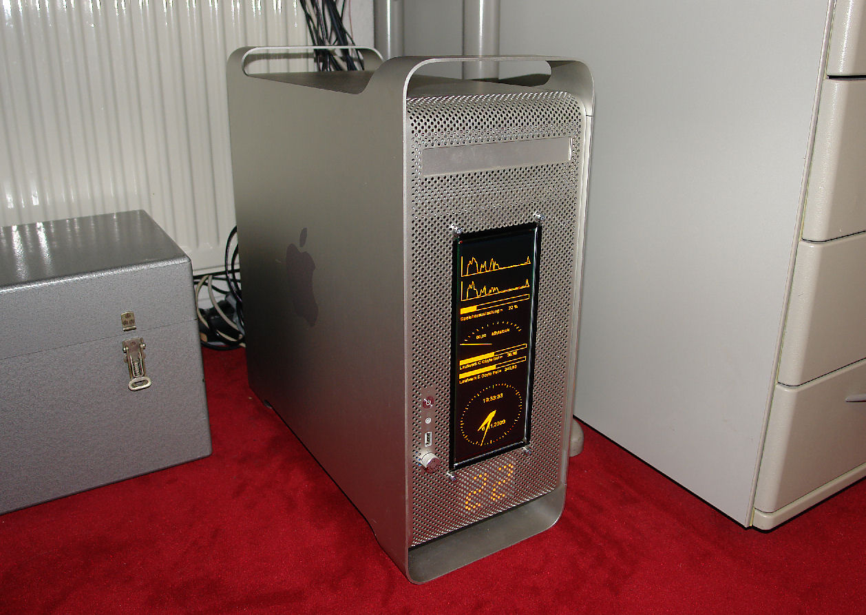

Markus sent me these pictures of a Planar EL.640.200 SK display modded in his case and being driven by USB13700 controller board. Looks good to me :)

the shematics are right, but i prefer to get the power direct from the power supply and not from your board.

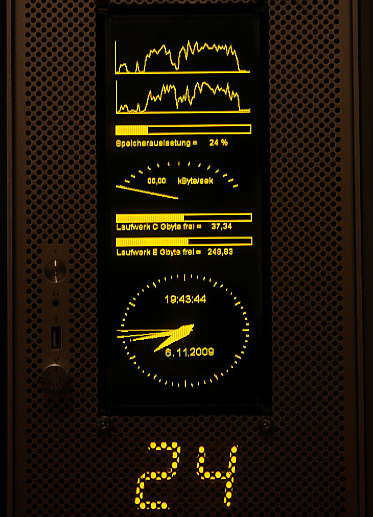

with conector 24 and a 100kohm poti against gnd it is possible to dimm the display and prevent burn ins. you can see the pot knop on my pictures below the front-usb conector.
thanks again henri for your great support and this great little board!
markus

Hello Henri
I wired up my EL 640.200 and it works perfekt, thanks for the schematics. :D
My conector 24 is also conected with a "poti",thanks mash.m for the Tip.
Edit:
Detail connected Potentiometer
Some more Pictures are HERE
