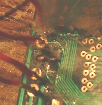

No problem. i hope that you got them. one is of the make-shift circuit. the other is what i get on the screen. i hope that is a simple error. thanks again. :lol: :!: :D :) :wink:

Here they are:
I rotated this one to fit better on the screen.

hey i still can't get any software to run on win2k. to test the software i have to boot in to win98. you guys say that it should work. i downloaded the DLPORTIO and installed it on win2k and it says that there is no driver running. when on 98 i just installed it and it recognised the driver. what an i doing wrong? =I

nope i tried reinstalling and still i get the same error. i am admin on my win2k PC what could be the problem? could it be another piece of software? i haven't installed another piece of HW on the parallel port. i use USB => anyhow i checked the connections. everything is connected with the solder in contact withe the points. i really dont want to re-solder the whole thing in fear that it would turn out like the contrast pin. 8O

ok the different version of the dlportio drivers did work and now i can open the software. the only problem is that the LCD doesn't display anything. i will restart my PC and see if it will work with the LPT on normal mode.

hey i am back.
i finally found some spare time and money to build that circuit. now the LCD does not display anything. i think that it has something to do with the paralell port type settings in the BIOS. what should they be? EPP(1.7, 1.9), ECP, Bi-directional, normal. i have tried many of these and i cannot remember what i got. what would you reccomend i set it to? oh and i tried every LCD program that i have LCDinfo, ks0108 test(both the one from your site and the one that you sent me), GIF animation.

With my KS0108 code there is only writing to the parallel port so I don't think the parallel port mode should affect much (it's always possible though). I'm using ECP with my displays and haven't had any problems yet.
If the parallel port settings don't make any difference and you have the DLPortIO driver working I don't know what else than wiring could be the problem.
